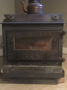

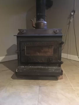

Hi guys new to the page here. Just purchased a house last year and I. The basement was a beautiful all nighter wood stove. Unfortunately I don’t know much about it I think it’s the Giant moe but not sure how to tell. Has a 24x18” door opening with a glass in door. Has an 8” flue and has blower. Tried looking through the forums on here but couldn’t find anything. Any information would be awesome! Also was reading something about a baffle for the all nighter stoves what is it and where would it go?
Thanks for any input!
Here are some pics of it

start here https://www.hearth.com/talk/threads/just-purchased-a-giant-moe.168341/#post-2261578 and go in the search box on the right top corner of this page and type in big moe

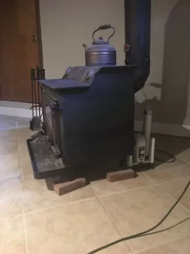

How much clearance do you have from the stove to the wall? And what is under the tile on the floor?
There’s roughly 3 feet from corner of the stove to wall and from the back where the flue comes out to the corner of the wall is about 5 feet. And it’s in my basement it’s surrounded by concrete

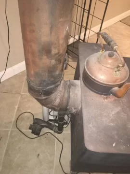

So the walls are completly non combustible? If so you are good other than lack of insulation. But if they are drywall your pipe is way to close as it enters the crock.
Yea the walls are 8” concrete that the flue goes through. The only combustible is the floor joists but those are about 6 feet away from anything. The stove was there when I bought the house I burned it last year with whatever wood I can scratch up found that maple burnt the best in the stove and it keeps the house a comfortable 73-75 degrees all winter
Good then the install is safe from what i can see
Yea when I got the house it had the carpet under and around it so I pulled it all up tiled it and made sure it had all the correct distances. And made sure everything was air tight. It has its own stand alone concrete block chimney with the rectangular ceramic flue. At least I think it’s ceramic not sure what they made it out of
Its terracotta typically called clay liners. Did you have the liners inspected? Does the chimney have proper clearances?
Honestly haven’t had anything inspected I looked down the chimney myself everything looks ok it burns good and pulls a great draft. As far as clearance I’m sure it does it clears the peak of the roof and it also has an air gap between the chimney and house with the aluminum siding in between so there’s an air buffer between it which not sure if that’s good or bad
Well the fact that it has a gap is very good and very uncommon to see. It should be 1" to any combustibles. You really should have the clay tiles inspected for cracking with a camera.
Yea it has about a 2-3” gap between the chimney and siding. And I’ll look into having a guy come check the tiles out. Thanks for all the input!

By the time Fisher started offering glass door models, their Fireplace Series had a factory "Smoke shelf Baffle". I don't know the air wash flow across glass in yours, so be careful how much you baffle it and create soot on the glass. The baffle plate just needs to be kept shorter (front to back) to avoid rolling smoke into the glass too much. The baffle should be designed for the chimney, as well as the stove, so principals apply from the baffle thread in the Fisher section.
