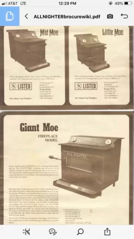

Well I would like to see them side by side but that might put a hole in the floor they look very close in weight one takes logs side to side the other length wise also giant Moe has 8” flue mid Moe has 6” I’m jealous keep them both for 200 you can’t lose.

Are you sure you don't have a Big Moe that would be larger? That takes a 30 inch log compared to Mid Moes 26-28.
Giant should have more square inches of heating surface than Mid Moe. BTU radiation goes by the surface temperature of each square inch of surface area. So the surface area of the hottest part which is the top radiates the most. Door area should be much more as well. You can do a calculation of BTU output with a infrared thermometer. You will be amazed how much cooler the sides get towards the bottom.
They didn't use BTU ratings back then, now the BTU ratings are not actual output, they are simply to fire the same load at the same air adjustment (not max output) for equal comparison. Real world heating has little to do with the BTU ratings. When these stoves were designed the heating area used was a 8 foot ceiling with insulated 2 X 4 walls in Seattle Washington. So thicker walls with more insulation, thermal windows, continuous vapor barrier, location, as well as many other factors determine actual heating capacity. (the chimney has a LOT to do with how these will heat) You can't compare them on the same chimney since the different models require different flues.
