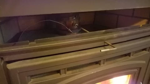

Great post, thanks for sharing. I'm starting to lean toward that idea, after looking at the drop in chimney top dampers I have concerns. Is your damper control accessible from the front of your stove / do you have a finished pic? Do you find you change the setting often, or is it more of a find a sweet spot and leave it there for the season? I would need to modify the exterior of the stove to accommodate this sort of damper with external control, so before I drill I'd want to measure 3 times.
Here is a pic of it with my PE insert I also used it on the Lopi that was previously installed. My chimney is 28' I always open 100% on start up and reload usually after the fire is burning good and supply is closed down, I close it all the way. After I start my fire and there is good char nice hot fire, I close my supply air next close my air boost then flue damper last. This is my procedure on most every fire.
the damper handle is centered above the door I will try to get a close up later.
[Hearth.com] Enviro Cabello 1200 burning too hot

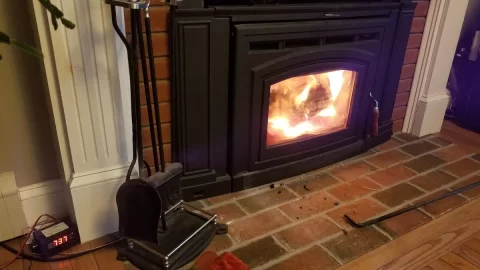

So ended up installing a 6" damper yesterday. I reloaded the stove this morning on coals and left both dampers open for about 3 min, then closed both when the temp as about 275. An hour later I'm at about 750 degrees. So that didn't work. I was able to verify the damper is closing fully before I put everything back together. And it's only about 32 deg outside. Only other thing I can think to try is the block off plates like John26 did in his install, would those holes make that much diffrence?
[Hearth.com] Enviro Cabello 1200 burning too hot [Hearth.com] Enviro Cabello 1200 burning too hot [Hearth.com] Enviro Cabello 1200 burning too hot
