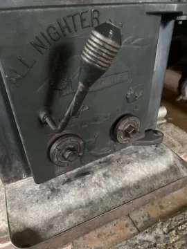

Would anyone be able to tell me about the dampers on the all nighter They no longer spin tightly shut - but keep spinning - as we know that doesn’t crest the air tight needed … thank you

Spin dampers are usually simple affairs. Open the door and look at the backside of the door where the spin dampers are. Turn the damper and see if a bolt head is turning. If so, there may be a locking nut that has loosened. If so, this may be addressed by opening up the spin damper fully until it comes off, exposing the locking nut.

What he said. Open the door and look at the back and or post a pic of it. Those 2 air controls should be able to unscrew completely off of the stove.

Thank you - as that was EXACTLY- the case - upon one adjustable and on 9/16 🤷‍♀️😄 the baffler plate ( hope i said that correctly) adjusted itself while doing so ! THANK YOU !
Tighten up the locking nut as best as possible. That should end the problem for another 20 yrs or more.
