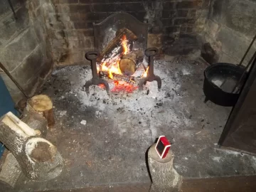

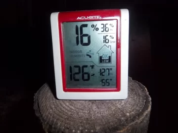

Three feet from the fire and it is at 126 degrees fahrenheit (127 before I turned it for photo). This is a small fire. I've had the temp gauge there less than 10 minutes. Heat is going up the chimney. But there is a lot of heat to spare. How hot is it 3 feet from your stove?

Sure, the air there also warms. But then gets sucked into and out of the chimney while it is being replaced by cold air...

So if I OAK it like some stove owners, I'm way ahead of the game. A conduit from a window to the firebox. Well constructed fireplaces are less efficient and take tending to; can't (or shouldn't) go run errands or let the pets wander. Otherwise they can be phenomenal heaters.
View attachment 289888 View attachment 289891
The reason temps are that low is the massive ammout of dilution air that goes up the chimney with the exhaust. That makes it extremely difficult to creat any meaningful heat with an open fireplace and often leads to a negative net heat output.
Also if your flue gasses are that low you will have big creosote problems

Ok I misunderstood I assumed you were messing flue gas temps which is why I said " Also if your flue gasses are that low you will have big creosote problems" . But yes that is pretty good radiant heat off the stove. Now what is your temp in the next room over with all other heat sources turned off all day?

For giggles (and not to make a point either way, because I don' t think it says enough about the situation to make a judgement about efficiency either way), I put a thermometer 3 ft in front of my stove. It died at 120 F... :-(
