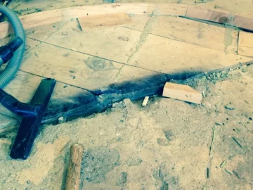

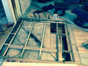

We remodeled a few years ago and I tore down the old stone Fireplace & chimney. It Was about dead center in the place and the decision was made to open the floor plan. This fireplace was at least 100 yrs old and had a stone And masonry base. The attached photos show the sub-floor once the hearth was replaced. We never had on open fire in as there was an Encore to a Dura-liner flue. How many fireplace fires would have been necessary to reach the reduced kindling temp caused by repeated heating and cooling of the subfloor?

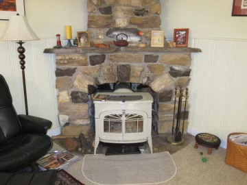

Pyrolysis at work. Do you have any before pictures of the fireplace? Did the fireplace hearth extend over the subfloor?
Not what I would have expected to see under a “fireplace” for structure.
[Hearth.com] Almost a house fire
This is a very old place, at least by CA standards. It appears that the front of the firebox was just over that seam. Petrified wood in the stone work. There is a small dungeon below with a single 12x12 concrete column supporting.
