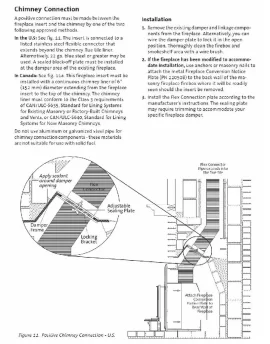

I'd be inclined to recommend an approved method.
Please advise the OP of "approved" methods and materials for block off plates and approved by who.
Reactions: pen
No problem smarty pants. They specify 22 guage blue steel. His manual likely varies some from this, but this should serve to point out that one's manual likely tells them how. [Hearth.com] Aluminum foil
