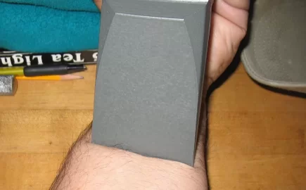

oldspark said:
I want to see you run mine over your forearm with out cutting it, I think they forgot to sharpen yours, dam near cut my hand putting in the holster one day.
Yeah, I must have gotten a dull one. Here it is, failing the forearm gashing test.

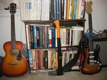

Anyway, it looks nice standing between two of my long time favorite axes. ;-)

Post a picture of the edge, it does not look like mine at all, I was not doubting you and stand by what I said before, they forgot to sharpen yours, any one know are they doing something different with the edge now.
The thickness of the teflon coating might make the edge seem duller than it actually is. Split a few logs first, to wear away the teflon from the edge and see if the edge is any sharper. With caution of course.

Yeah, I thought about that. Seems pretty thick, and it completely covers the edge. Interesting thing is that the packaging that came with the splitter says to use the Fiskars sharpener to maintain the edge. I've used sharpeners like that before. If it ain't sharp now, it sure will be after I run it through that device several times. ;-) I'm taking everyone's advice to heart, and I plan on being extra careful with it until I get a feeling for it. I thinks that's sound advice for any new tool.

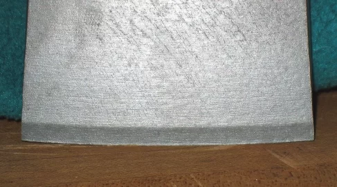

oldspark said:
There was a protective coating on mine when I received it but that was obvious.

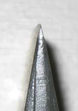

I'm curious to hear how your edge differs from mine. Mine has a secondary bevel about 3/16" wide (very slightly hollow-ground) all across the edge. There is also a very slight radius to the edge as can be seen in the photo of the edge resting against the counter top.
The other photo is the best I could do to show the grind in profile.

Yours does look like mine so not sure if there is a difference, I do know I would not feel comfortable pushing it into my for arm like yu did, I was surprised you could do that. I would take a picture but do not think it would show anything.
