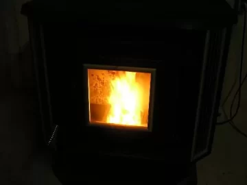

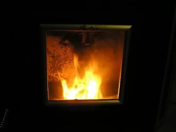

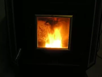

OK finally able to get pictures up. Hopefully I got it right. The burning pictures are taken after an hour of burning at heat range 5 and fan at 5.
Factory 6-4-1 settings and burning potomac pellets.
Temps are as follows
Room 72 deg
Room blower 98 deg
Top front 120 deg
Top of hopper 85 deg
Left of door 356 deg
Right of door 321 deg
Exhaust pipe 93 deg
Exhaust outlet 370 deg

Gordo, that looks to be a pretty good to me, after an hour. What were the other 2 brands of pellets that you burned?
Deffy said:
theres the problem, 370 degree air out of your exhaust. your heat is making it outside and not being picked up by the exchanger. you sure its clean?. try lowering the burn air a bit and see what effect that has on the exhaust output temp.
your flame looks perfectly fine for those settings.
i would set the stove on 2-5, let it burn an hour and take your temps, then tweak the low burn air as low as it can go without causing problems such as unburnt pellets.
