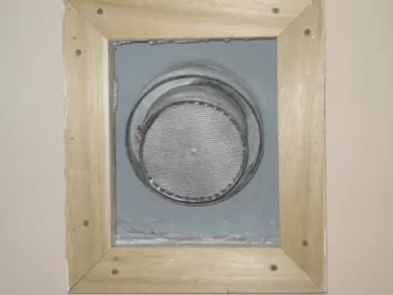

The previous owner had a wood stove in the unfinished basement. We finished the basement and now want to put a wood stove in. The pipe that comes into the basement sticks out into the room about 2-3". We put up a 2x3 wall with sheetrock. There is a 2" space from pipe to stud/sheetrock all around the pipe. Do I need to make the hole/space bigger to 6". I'm having a hard time finding an answer. I'm thinking just cut the hole bigger to be safe. Any ideas.

6" does not sound like enough on an uninsulated pipe. Is it going into a clay liner? Pictures help greatly with questions like this.
Is this pipe sticking out the wall just regular 24 ga stove pipe? Or is it an approved through wall thimble? If stove pipe, it doesn't meet the clearance and if it's an insulated thimble it might, but you would have to find out what type of thimble and what it's clearances are.
I know the pipe isn't regualr stove pipe. I think it is chimney pipe it looks the same as the stuff on the outside. I don't know if it is a thimble or chimney pipe. I included a picture. I took the trim from around the hole off. I plan on using double wall pipe. I don't mind making the hole bigger but if I don't have to. Thanks for the help.
