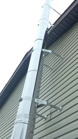

View attachment 107720 View attachment 107721
know this is an old thread but DexterDay where did you get those chimney wall band straps?
I think he had custom extensions made up and painted them silver. Search on his old threads. He posted the details a while back.
Nor am I, apparently he has left the forum. He had end plates cut up, drilled them for bolting of the flanges, them had them welded up to square stock to make the extensions. then he sprayed them silver.
