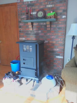

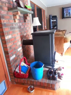

Here is my current setup. A TempCoal stove set on a raised hearth. The hearth wall is 53" across. It is also 53" to the bottom of the bluestone mantle. It's 24" to the center of the existing 6" thimble or 27 1/4" to the top of the thimble.

That low thimble is killing your options. It looks like you could gain about 5-6" height by removing the hearth and putting one in at floor level. That would help. One stove you might consider then is the Jotul F50 or F55. This is a cast iron jacketed steel stove, just like the Alderlea, but it can be rear vented.

2. Looking at the pictures, a large stove in a low ceiling room, if that room is not huge, and open , prepare to take off some clothing. Or share the rest of your floor plan. If this is a typical North East old school home with smaller walled rooms, a T6 in a small family room with low ceilings is gonna be very warm.
3. The existing hearth looks a bit small especially with hardwood floors butting up to the brick.
If it were me, I would take a deep breath, consider how long am I going to be living in this place, and consider modifications needed for the chimney and hearth before shelling out for any stove, which may not work or fit well with the currently existing chimney system and hearth. Watch your heating bill, look at your furnace BTU rating etc to get a feel of your homes need for heating BTU's.

No matter what you choose, I think you need to lift up that stove pipe. It'll cost a bit, but give you much more flexability.

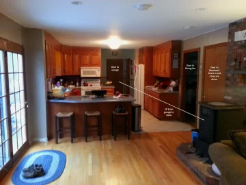

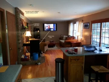

Here are a couple more pics. I added text & arrows to the pics but now I see it came our very small. If you open the pic in a new window it's easier to read. It is 18' from the TV wall to the stove and 28' from the opposite wall to the stove.We just bought this house in July. My original intent was to immediately replace the coal stove with wood but the previous owner convinced me to give coal a shot. Our experience has been mixed at best.
Our layout is fairly open but somewhat narrow. Our ceilings are standard 8'. We spend the bulk of our time in the space in the two pics which is basically the back half of the first floor. Heat does have two doorways to travel around and up the stairs to the 2nd floor which has 4 small BRs & 2 BA. (approx. 1000sqft) Our only other source of heat is electric baseboard. Our electric bills have climbed from $140 October, $269 November, $320 December. Our old house was about the same size with electric heat as well and with the Jotul F600 we never had to run the electric heat. Our temps averaged 66-72. As I sit and write this it's 64 here in the kitchen. :(
My intent here was to find another large wood stove and just swap and keep moving. I had had a Dutchwest stove years ago and went through the hassle of replacing catalytic converters every couple years. Up until my old non-cat F600 developed an air leak I was quite happy and would have been fine buying another. Late yesterday I got a quote from Superior for a Jotul F500 Oslo, w/short leg kit, rear heat shield, delivered & set on my hearth for $2750 plus tax. They would do the hookup for another $300. I plan to swing by their showroom later today. I had been pretty hot on the Progress Hybrid but am not sure what to make of some folks having to disassemble & clean the cat converter on a monthly basis ?? Been reading some on their Steel Hybrid too. Somebody mentioned the stove being available for sale around June this year ?

I think you would be ok with the T6, it convects nicely. I would not cut a vent right above the stove. Instead I think a small table fan blowing cooler air at floor level, from the front room into the stove room will suffice to get a good convection loop going.
There's a bunch of code rules wrt to cutting openings for registers between floor. Do a quick search and you'll find a bunch of info. Basically code around here says for a drywall ceiling between floors it has to be at least 6 ft away from the stove and must be an enclosed fully metal duct. In some areas they go one step further and require a fusible link to shut the opening in the event of a problem. Not a major thing to do, just check your codes for accurate requirements.
