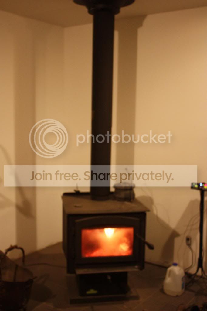

Describe the flue on the stove from stove to cap.
Its just a basic Selkirk install. It's about 60" from stove top to the collar where it goes into the Selkirk. Above the roof there is ~5' of pipe that is topped with a raincap. It's all 6" pipe.
Perhaps a picture would be better

Reworked the ole Nappy, built a hearth, and installed a straight shot of double wall ICC pipe at the first of the season.
I now have no problems with the stove cruising at 600+ STT while the damper is set at #2 of 6. The straight pipe made a big improvement in performance.
However Im still having problems with getting enough heat out of the stove into the room, burn time length and ash buildup. Wood is decently dry, no hissing. Lights easy from coals. I misplaced my moisture meter so I cant give an exact number.
So, I can honestly say I gave the old Napoleon a good chance and Im getting the most I can out of it but its still not enough, particularly when the outside temps are lower than -10*C..
