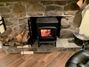

I purchased and installed the Jotul a little over a week ago. So far I like it. It is installed on 25' of insulated liner and I'm having a very hard time controlling the temps. I'm shutting it down the second the logs start to flame and it still runs away. Not even on a full load. I am burning VERY seasoned wood, 4 years at around 16 percent, so that could be contributing. I have the secondary plugged up with aluminum foil and that seems to be keeping everything in check. My setup isn't god for a pipe damper, so I'll have to live with blocking off air to the stove. I have some magnets coming this week to try to get rid of the foil.
As for a comparison of the two stoves, my PE is an absolute work horse. It starts in November and doesn't shut off until April. 2 FULL loads a day and the house is warm. It is an easy breather, but once I got it all figured out it peaks at 720-750. I did just notice my first small cracked weld on the inside of the door by the baffle rail. I'm going to monitor it, but burning as is for now. The floating baffle is great and can take a beating. I don't have an ash door so I can't comment. TBH I don't think its necessary. Stove is very well built and will replace with the exact same stove when it is time to retire it.
As for the F45, I also feel it was a well built stove. Steel stove, with cast panels. I didn't take any objections to the glass, but didn't study it too deeply. I think the door latch is much nicer than the PE. The baffle on the F45 is good, although I wish some of the holes pointed down. All the holes point horizontally towards the face, and the burn just gets sucked straight out chimney. The PE has a series of holes that point down and do a great job of actually burning wood. Overall I think it is a very high quality stove and should work great. The main reason I chose this stove was for the rear exit, N/S loading and non-cat. I couldn't fit a PE downstairs or I would have installed one.
I think you will be ok with either stove and I am very happy with my F45 purchase. My PE has proven its worth in gold to me, so I am biased, for now, towards that stove.
