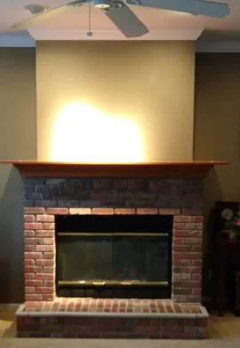

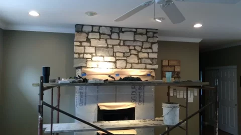

I finally had some time to post pics of my FP30 install. After much research and some help from you fine folks, I decided to do the demo and install myself. I have never done any stone work so I elected to pay someone else to do that since this is the focal point of our house.

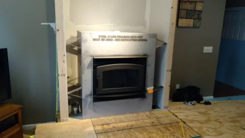

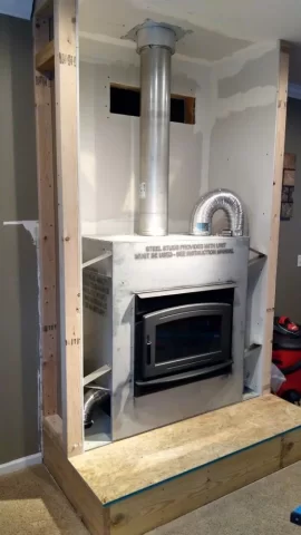

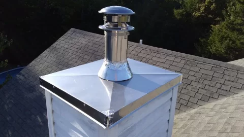

Existing fireplace (heatilator ec42), chimney, and rusting galvanized chase top were completely removed. The minimum 2" to combustibles was NOT met on the existing chimney. The new fireplace is a PE FP30 arch with remote heat duct kit to the basement. 16' of class A (TLC) and a new stainless chase cover. The stone is a natural thin cut veneer (Semco Rockport Blend) and the hearth is the same.

Before and install pics:
[Hearth.com] Another PE FP30 install

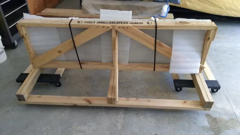

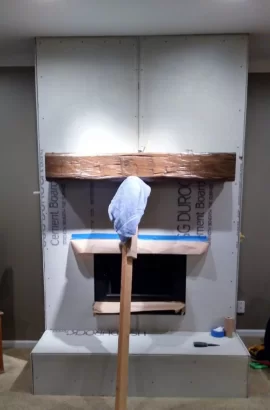

I was really worried about getting the thing in and on the raised hearth. I built a ramp and used furniture dollies. Three of us lifted it while my wife slid the furniture dollies out.
[Hearth.com] Another PE FP30 install [Hearth.com] Another PE FP30 install

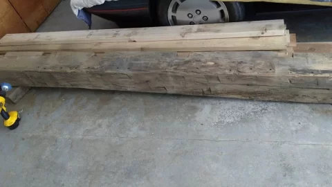

100+ year old hand hewn barn beam. I used a nylon cup brush and 3 different stains to get the look we were after.
Beam after:

Stone work in progress!

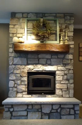

After (note the mortar is not yet quite dry in this pic) :
