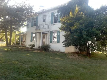

I bought a pel pro 120 from menards as they offered for 900 online. Couldn't turn it down. It took me forever to install it with the snow on the roof and alot of Budweiser. However it heats well. It does go through alot of pellets but I'm still "learning it" , and I refuse to use my 4.95/gallon fuel oil. It's currently 16f outside and with a electric heater in my bedroom and my stove its at 68 inside. Not bad for a 200yr old two story farm house. Only isuue I've had is pellets sticking to the ledge from the burn pot and the Shute. However thanks to "lake girl" I e adjusted it and problem solved. I think this stove has been a good investment.
