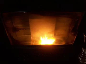

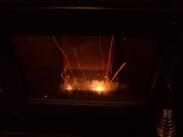

    my 03 is about the same on the inside, as far as i can tell, same motors.blowers, sensors, hopper shape tin metal postions everything.
    outside, i see the hopper lid is large on the 09, the front has no door for ash, the 03 had a door-not a pan but just a door. the front door has a differnent hinge on it.
    the exhaust blower on the 03 had a moulded tin on the output then you attach your exhaust to that inside the box. the 09 now has a longer output and then a 2 piece exhaust extending past the back panel. the damper rod is slightly changed its shape on the inside of the intake hole, it now has holes in the plate and doesnt close as tightly as my 03.
    i bought an 09 3 weeks ago, i never got it to flame, so i exchanged it, new one does the same thing. i troubled shooted with pelpro for days, im returning this one and just stocking up on parts for my 03 model. conclusion we came to was maybe the guy who sealed the intake box forgot on both boxes the same seal position on both....sound crazy? both were same month and same year models, ive rund my 03 for a few years now and it flames perfectly, i asked if they made them a non flaming upgrade to them, he said no way they should flame. i even closed the hoel completly to the intake, and it still pops sparks etc...so i need to move on.
    i still trust my 03, but the exhaust is on its way out, this is my only heat source so i wanted a back-up. i wanted to stay with the same model to swap parts if one fails.
    seems like the boxy style puts a few more btu than the fancier looking ones.
    so im now considering the englander 2000sq 25pah box style, lowes and home depot sell em around 1500. huge plus for me is i can get the fan off the shelf.
    i would love some feedback on this style.
    1st picture is my 03, 2nd 09. same speed 1.

    You have way too much burn air being drawn into the fire box. The combustion blower may be too big or the control panel may not be outputting the correct voltage for each speed. You can put a Digital volt meter on the blower and see.

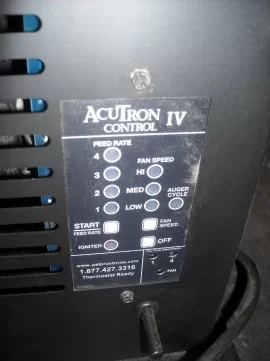

    Well, I just popped in a new Accutron IV control board that actually says Accutron IV on the panel! It is a new batch! The Pelpro instructions do not get updated very much so we will have to do some testing here!

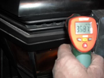

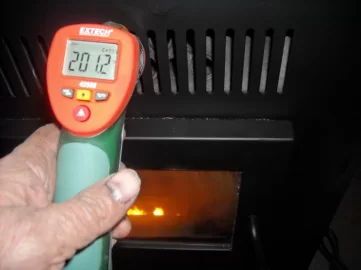

    Anyway, to prove a point I am using my IR gun for a heat comparison!
    The Pelpro is set to Heat Level 3 out of 4 with the 265 CFM room blower on the lowest setting 1 out of 5.
    201.2 Degrees F
    The Avalon Astoria is set to Heat Level 2 out of 6 with the 165 CFM room blower on 6 out of 6
    368.1 Degrees F
    That is quite a difference!

    Hard to compare stoves like that, You'd need to get em both burning the same pounds per hour and figure the fan settings to get the CFM as close as possible. Bet the temps get much closer. Prolly need to compare exhaust temps as well.
    If you can get the voltage reading going to the fan. You might be able to get a setting that would better compare the cfm's of the monster blower to the smaller one. Or maybe install a similar cfm blower in the pelpro compared to the Avalon. Then run em at a similar pounds per hour feed rate.
    With the pelpros blower being 38% larger. you might be able to run the pelpro's blower 38% slower or the Avalon 38% faster to get a better comparion. But any time you increase the blower size you will loose heat from the convection if the heat exchanger can handle the extra volume of air being passed thru it.

    so i popped a 07 burn pot in my 03 stove, the only thing i can see thats different is the side walls are about 2 inches taller then the 03. so i was thinking hey itll hold the pellets in for more burn. right..
    so.
    i put it in - immediatly i got sparking- my orig 03 pot does not spark.... what the heck..?
    the 07 pot is actually slightly wider, about one 8th on each side if centered., tighter fit than my 03.
    --- think about a tube maybe 2 feet long. fan blowing thru the tube, you measure at the out end the breeze is coming from, you get measurement A. if you pop holes in the side all over the tube, your not gonna get A again.. so this small 8th of a space closed now is making more air in the pot(making some sparks fly).
    im thinking about making another slot or more holes in the 07 pot to distribute more air. because im thinking no sparks means more solid of a burn.
    what do you think?
    o and with the 07 pot running right now i have to have my damper rod completely closed with feed rate 1.. small to no flame.
    with the 03 pot same feed rate- if i close the damper rod completely it would back up.

    Unlike the Astoria digital control panel, you can run the Pelpro convection blower at a lower setting than the heat level and even turn it off! Pelpro tech support does not recommend turning the fan off! However for more heat they do recommend running the fan on the lowest setting. I finally got it in the workshop for testing last night. So it being a nice 24 degrees outside this morning I will be testing it today.
    The workshop was 24 Degrees F this morning and the Pelpro warmed it up to 75 Degrees in approx 45 mins with the convection fan on LOW. Not bad! The Pelpros are a really good stove for the money, I am just trying to figure them out! LOL
    The fan shutdown properly and it all works good!
