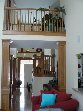

    Here is a strange photo stitched together showing the stove room. Lots of windows, ceiling fans to move the heat.

    The pic in the last pic was right as I was getting ready to take the Fireview out, couch was moved and I had the new stone laid out on the floor next to the hearth so I could figure out where each stone was going.
    Here is a pic of the opposite side of the room, facing the front of the house. You can see how the air moves up then toward the front of the house and falls as it cools and moves back toward the stove.
