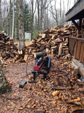

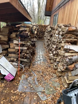

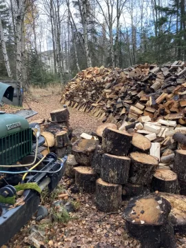

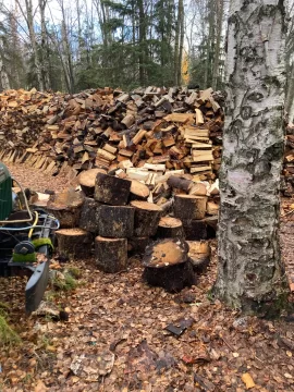

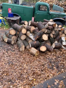

We all love pictures. Especially from cool places like Alaska.

Sweet powerwagon!
Do you have a M37 as well?
