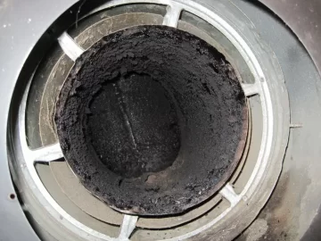

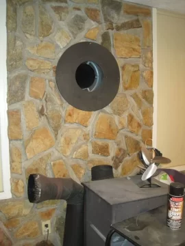

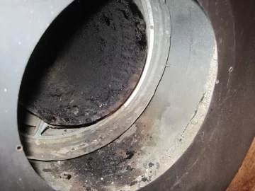

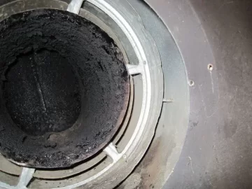

Ok firstly, yes I know there is a lot of creosote, I guess that's what you get with a old smoke dragon, not really seasoned wood, and ya tamp it down for overnight burns. I do clean it very regularly during the burning season, got my own brushes and rods and what not. Anyways, looks like triple wall pipe I guess, does anyone know what kind or what brand would be able to put a section through before hooking up to my double wall stove pipe? I cannot tell what is behind the face of the stone, all the cracks are mortared and what not, any advice, preferably with web links would be great. Thanks, James

I handled that situation with a Simpson thimble. My issue was a 5.5" liner so the six inch extension in the thimble kit fit over the 5.5" pipe. I packed the first three inches between them with stove gasket and then locked it in with furnace cement. In your case I would use a stainless adapter that fits inside, yes I know the drip down concern but that stuff is going to end up in the tee, the pipe that is there and that will mate up to your connector pipe inside.
Edit: I just looked back at that thimble pic with the stove pulled out. You have a 8" pipe in that wall just like the 8" crock I have. A stainless 8" to 6" adapter that mates up to your connector pipe will handle it just fine.

Were it me I would treat that eight inch pipe just like a ceramic "crock" going through the wall like mine does. I would install a SS six inch pipe through it going even with where the eight inch ends at the tee. Then attach my six inch connector pipe to that and secure it.
