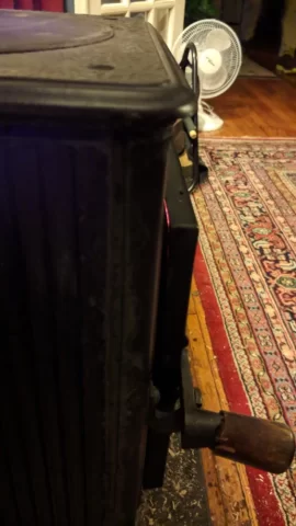

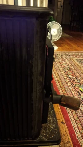

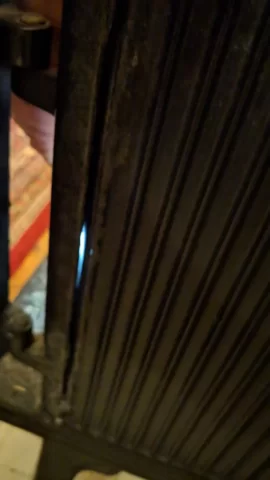

Well, don't know why it took me so long to find this. Rebuilt it last year and had the same issues. This year, fired it up and noticed a gap on the side, right at the front plate. And another one on the other side. They look so obvious, I can't believe I missed them before. Cemented them up, I'll light it tomorrow...hopefully that cures all my ills!
Is this the one you rebuilt? That leakage could make a big difference.
Yeah, it's the one I rebuilt. The strange thing is I *looked hard* for a leak last year after the rebuild and didn't see one. In all fairness, the leak was only visible from certain angles, but still. IIRC I went around the seams with incense--but maybe I'm just thinking that that's what I should have done; I know I did it around the glass and doors. I finally managed to get it burning a little cooler by using the pipe damper, but never thought that that should be necessary. I'll let y'all know if this fixes it. I'll give it a good test with a bunch of bricks this weekend.

Wow. So was still having problems. Didn't see any more obvious leaks, but when using a bellows to restart I noticed smoke puff out the back when I, uh, bellowed. The stove goes together tongue and groove style, and bolts together. When I reassembled, I slathered cement in the groove. However, I didn't pack it into the seams after it was together. Apparently that was a mistake. Not sure how much air was leaking into the combustion chamber v. into the exhaust, but I can't believe that I didn't appreciate it before. I cemented the seams, and it's a different stove. I have much more control now, and at least for the first few fires it's been noticeably less peaky. Same load as above (2 oak 4x4's and 7 liberty bricks), and it actually smoldered with the air all the way closed--that's about as much as I can pack the stove, and it doesn't get much drier than that. Eventually settled in at 800-850 griddle temp and 7-750 peak stovetop temp, which is just about perfect on this stove. I'm going to have to relearn this thing.
Normally a good bead of quality stove cement on the grooves before assembly works. There should be enough applied that it oozes inside and out. Finger trowel the inside ooze and also the outside ooze, then wipe around the outside joint clean. That worked for our stove reassembly.
You'd think. Not sure what happened. There were definitely gaps outside, but they didn't look like they communicated. And who knows whether it was just one spot or more. Either way, it's probably good insurance to fill the gaps outside... Looks better too.
