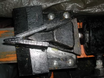

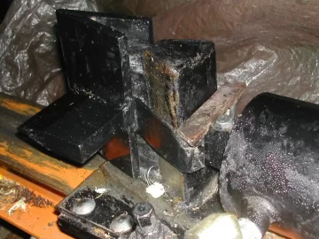

I agree with the Northern Tool slip-on. Minor things with mine...First: existing wedge is quite wide, requiring slicing and spreading the rear strap of slip-on and welding on a cross piece. Second: As seen in top view, the difference in angles between the two wedges allows movement of the slip-on, and after a cord of working, the rather thin strap broke off. No biggie, will get some proper metal, say 1/4"thick and 1.5" wide steel and form it to a snugger fit and re-weld.
Otherwise, at $80, it's an economical upgrade that substantially increases productivity.
