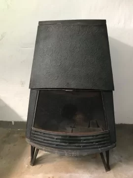

any info on this stove?
MNman2
Nov 30, 2018
9
MN
Wood stove/Trolla Brug
model name / number: Trollapeisen
Vintage cast iron Trollapeisen made in Norway by Trolla Brug.
Small "footprint". Could be a corner stove.
Has fire brick, log rack & front screen. Unique color.
very cool looking:) I do hope to get some heat out of it, but it wouldn't be a primary heat source.
New installation with lots of space so pretty flexible.

Trollapeisen means Trolla Fireplace. This model may not have a door, just a firescreen.
looks like the pic in #
the pic in the ad shows just a firescreen, so I think it has no actual door.
and...am I correct in assuming theres no way is this thing ul listed? which means my insurance company wont allow it.
Unless it has a ul plate on the back it is not listed. Even if it had one originally it the plate is gone it's unlisted.
