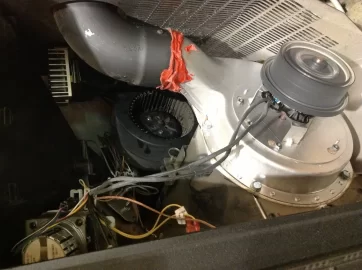

Stove is in start up.
As you look at the stove the right hand side cover is off.
The nearest motor "exhaust" is spinning m
The biggest fan at the other side is not moving. At what stage does this fan engage
Fuel is flaming up. Big fan still not on .
[Hearth.com] Any Ireland quadrafire mt vernon owners!!!!
The black fan that's in need of a cleaning is the room convection fan and that will come on when the stove senses that is warm enough to do so. If I remember Quads switches it on at about 180 degrees F. The silver exhaust fan should start as soon as it calls for heat on startup. It appears as though you are not getting enough fuel into the burn chamber to keep a good fire going. Hopefully someone will chime in about how to set up the feed rate. There's a common quote on this site about if it don't work clean it and if that don't work clean it again. Check the feed auger for something possibly plugging or restricting the movement of pellets. Wish I knew a bit more about this model.
