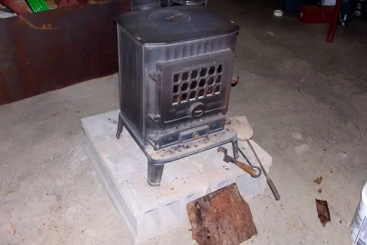

any one really had to rebuild a cast iron stove?
Bobcatter
Jan 23, 2009
31
Pennsylvania
I'm looking to replace a cast iron basement stove that I have had for 24 years and have burned for 12. I like the cast iron radiant heat and don't have any clearance issues. It is a Coalbrookdale Much Wenlock. Even though it has been moved several times (by myself and a hand cart up and "gasp" down steps, it as tight as it was on day one. Pic attached.

I've rebuild a few. Your stove doesn't look like a new EPA stove. It is hard to tell from the pictures if it is airtight either. The door/window look pretty open. Is there glass there or mica. I can't tell how old it is.
You should be able to see light shining through the seams if you put a bright trouble light in the stove in a very dark room.
That stove looks like a nice old piece. It most likely burns pretty nice and uses a bit of wood. I like the old units. Not for primary long burns, but for the basement, shop, etc. But even that depends on how much wood you have. And, you do have to watch the chimney for build up.
When it's burning, is all the fire on one side when you cut the air back? If so, you've got a little leak right there bub...
Runaway fire is a good indicator there is a major leak, but with small leaks you'll get changes in flame dispersion and pattern, location.... shorter burn times.
