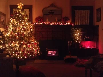

I've had a Model 21 insert for about a year. I think it's great. It is on the ground floor which is about 1000 sq ft. Granted it's a small firebox but it really puts out. I burn really dry black locust and silver maple. I have a 5.5" ss liner 30 ft up a terra cotta lined chimney. It draws great and fires start up fast and hot with very little kindling. Have learned how to cut back the damper and get decent burn times with temps usually settling down at about 550 deg. It will linger at that temp for quite a while as the coals burn down. No real overnight burns but if I load it late usually have enough coals to start up in the morning with little or no kindling. The living room is large and heats it well and warms into the dining room as well. The thermostat on my furnace is just close enough to cut off when set at 68 deg as stove gets going. The fan works good but never really use it since we usually settle into the living room in the evening. On the -9 night we had recently I ran the fan for a short time at the start. When stove top temp gets a little high turning the fan on cools it off quickly. It looks like a bigger stove than it actually is. It's the only insert that would fit in my existing fireplace and I couldn't be more pleased with it.
