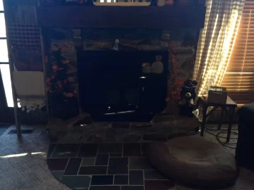

Yea the 20 inches fit in the ol country comfort. Not very clear there [Hearth.com] Any stoves from big box to consider?

Yea the 20 inches fit in the ol country comfort. Not very clear thereView attachment 114220
