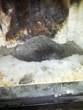

I cleaned mine from the bottom & it worked out pretty well. I didn't follow the directions exactly & I didn't end up with a mess. I took the plastic & just duck taped it to my fireplace. I ran the soot eater under the plastic. I managed to get a good bit out & did not make a mess. Here is a picture of what came down. This is from at least 2 years of use, not really sure when it cleaned before as we moved in just over 2 years ago. Now I'm looking forward to seeing how my chimney does this year with well seasoned wood.

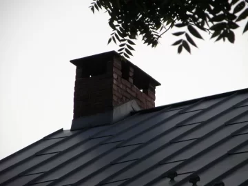

I don't have a screened cap, just one of these

And I just run the sooteater all the way up to the top till I feel the resistance of it bumping the underside of the cap. I run it quite a bit up there to clean out the cap. Usually I run the sooteater in one direction on the way up (closkwise say) and then in the other direction on the way down.
This does work very well to clean the cap, I just went on the roof to check it last weekend and the cap and top few feet of the liner where spotless.
