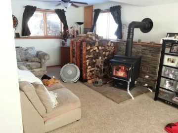

Here's how the stove sits:
Forum couch area

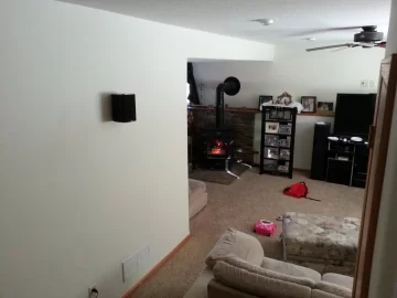

From stairwell

I have no problem keeping the upstairs between 72-74 (outside temp of 1 and some solar gain) with the stove set as tight as it is allowed by stops on the levers during the start and middle of a burn. I would actually not mind it a tad cooler. My basement ends up about 82-84. Which is great in the morning shorts and t-shirt pajamas! But not with pants. With the fan where it sits in the pic it is a little cooler right now, but also a little smaller load.
My wife works in home but with a newborn consuming her time, I want to beable to load the stove before leaving for work and not have her worry about it. But in the same token she wants to sit downstairs by the tv and not be cooked DONE like dinner! Ahhh the trade offs!

Its an epa 3100 step top. Just replaced the glass gasket and the upper baffle blanket this fall. Door gasket passes the dollar bill test. So it should be running at max efficiency. Obviously too well! Refer to prior post as far as no matter how I shut it down it likes 700.
Congrats on the little one! Pretty setup, also.
I second the idea of mixing in lower btu wood or smaller loads. I did this in warmer weather to even out a small epa non cat I had previously. I often woke to the sound of the heat pump going, but didn't get cooked out .
Not familiar with the clearances to combustibles on your stove...but is that wood too close?
Thanks!
I'm good. Its shielded on the sides. So 12" per the manual. I'm actually 17. The angle is a little deceiving. Corner clearance recommended is 6" and I'm 17 from the closest, rear corner even. As the stove is some what chanted towards the stair way.
