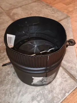

I actually bought a damper but couldn't figure out how to install it with my pipe. It fit down in the stove perfectly, but was the exact same size as my flue pipe and so it wouldn't go down in. It's a Selkirk and I thought they were universal. The company that installed my flue peeled the sticker off and I couldn't tell you what brand it is. Some pics for reference? I made myself a single wall flue damper, but when I shoved the double wall flue down in, the crimped part of the single wall left a little gap and actually bent the double wall in a bit to accommodate it. It worked to slow the fire down, but then I kept getting whiffs of smoke near the stove. It was my understanding with single wall, because of the crimps, they always have little gaps, but the draw of the chimney keeps air coming in rather than letting flue gases out.
Can you post a couple of pictures of the actual stove pipe and whole install that includes the ceiling support box? For double-wall stove pipe, the damper section either needs to match the brand, or if just buying the damper, it needs a longer mandrel to accomodate the additional pipe width. It might be possible to pull the damper out and install it in the connected stovepipe if you are handy at DIY installs.
That is a DW with damper built in, be mindful on install to make sure the arrow is going up, thats the direction the smoke needs to go. If in a singlewall pipe, a damper is pretty easy, two 1/4" holes in the pipe and assemble the damper in. For DW pipe you might need the stove adaptor for the stove first, then the damper section (6SA1, 6DK-1 I believe are the PNs.) Stay warm.
Luckily not only does it have an arrow, but it says "to stove" so even a Caveman like me can't mess it up. But with it installed correctly, there's no way to get my DW pipe on it. The second PN you gave me, is what I bought, pretty sure. Someone mentioned in an earlier post that I'd have to find a damper that matches the brand of the pipe. I did make myself this little monstrosity out of snap-together single-wall, but smoke kept seeming to come out where the crimp is if I'd damper it down.
Sure, I don't know if my attachments are making any sense. On the first pic, the smaller sliding section that slides out is going down. The second pic is the top of the double wall pipe. And the third one is my support box. The fourth is the whole setup. The last one is where the pipe goes in the ceiling support box. The installer said he didn't understand the fitting of the support box, like something was missing, but it fit kind of loosely, so he added some stove cement and put in the screws and signed off on it. But why is the crimped section on the outside? Oh my. Did he put the flue on upside down?

That looks a bit like Selkirk at the top, but not at the joints. They have the outer jacket crimp facing upwards. Maybe this is an older, discontinued style?
Is it possible it's upside down? There are two crimped ends smashed together.
Edit: I don't have a clue collar? I don't think so, anyway.
Did you have the new Selkirk damper facing the right way with the crimp at the top? The crimped end goes on top. and fits between the inner and outer later of the double-wall stove pipe.
That's correct. This is for modern Selkirk DSP pipe. The crimped end fits as previously described.
So, I just read the Selkirk double wall chimney pipe installation instructions and they say that the crimped end goes up and into a chimney adapter that connects to the crimped end coming down from the box. However it also shows a lower crimped end inside that can go down into the stove. Mine is totally smoothe inside, though.
Reactions: stovelark
At this point I think I'm missing a chimney adapter and have been for three winters now. But I don't understand the smoothe bottom of my telescoping pipe. All the instruction manuals show both ends being crimped.
Is the smaller section of the telescoping piece that comes out supposed to be coming down or going up?
If this was DSP stovepipe then the bottom inner layer would be crimped. That's why I wondered if this is an older product. How old is the stove pipe?
This is what modern DSP looks like.
[Hearth.com] Is this too much fire in Drolet Deco?
The chimney adapter is up top at the ceiling support box. Not at the bottom.
