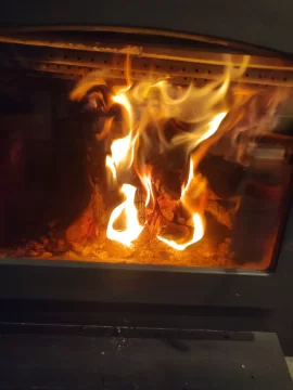

Shame on me I'm not monitoring flue temps. The stove sits back in my fireplace and the liner comes straight down to the adapter and then to the stove. It would be hard for me to get a visible prob in there while running a damper. This is a photo of my burn 1 hr in stove temp already 550 and the stove is half loaded since it is finally a warmer 40 degree day. It looks hot and rambunctious to me with the air fully closed and damper open especially being half loaded. Oh, door and glass gaskets are good. Proper high density door gasket is being used. Door passes the dollar bill test.

That doesn't look too rambunctious, but it's a single, still shot. Does closing off the pipe damper tame it down more?

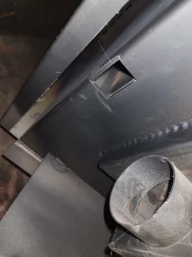

Double checked nothing in the front corners. Here is a photo of the rear I believe the boost air comes from the rear via the small square inlet
That is probably the unregulated secondary air intake.
I would expect that to be the secondary air intake. Hopefully someone with the 30-NC will chime in with the boost air locations. If not, I believe there was a thread way back that had some shots of them. Can you post a shot like this of the front underside?
The NC30 had 4 secondary burn tubes and the doghouse. The NC32 (I believe) has 5 burn tubes and no doghouse. If there's no doghouse there wouldn't be holes behind the legs to feed air to it. Yes, the rectangle cutout in the bottom back feeds the secondary tubes.
Thanks Nick. I haven't seen a 32-NC yet, but verified 5 burn tubes via the manual. So no boost air at all? That's unusual but possible I guess. I'd like to see a photo of the front underside including the air control.

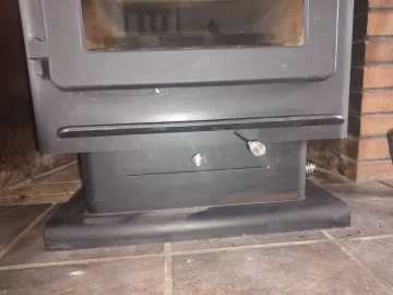

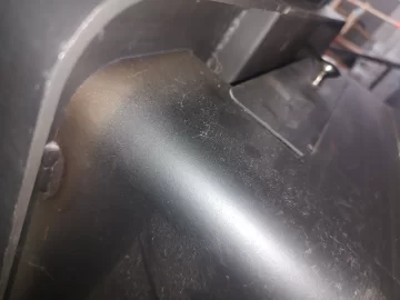

Here are some photos of the air control and the under side front of the stove. No dog house inside the stove and yes 5 burn tubes
  • [Hearth.com] Englander 32- NC
