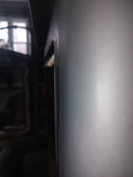

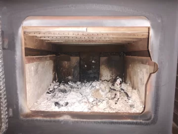

Thanks for the front images. Can you post a side view picture of the stove with the door open so that it shows the airwash diverter clearly? Adjusting this may also present a possible solution as noted in the thread link posted earlier.

Here are some pics of the air wash plate protrusion past the stove body.

The video looks like a near perfect secondary combustion. Try working with that setting for a bit and continue with aggressively reducing the primary air to keep the flames lazy. The airwash diverter looks about right.
