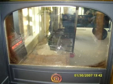

I've noticed this year that the natural air flow is definitely restricted on the left side of the box. I did a smoke test accidentally ;) and could see a "dead spot" on the left where the primary air manifold simply does not direct much, if any, air down that left side of the glass. I don't believe I have any obstructions. This is IMO a design limit of the air manifold air flow. I now bias my wood loads to the right side of the box or a few inches back from the left side glass and my glass stays pretty clean (only a little brown stuff on the left side, but not so much that it bothers me). Any time the fire is smoldering early in a new fire and thus the draft is not yet to it's peak with a warm chimney, you'll probably experience glass fouling. That's why I burn the first half hour with the door open (hearth screen in place), the second half hour with the door closed, but the cat UNengaged, and then engage the cat at around the 1 hour mark. I'll include a photo of my glass that I haven't cleaned in weeks in a subsequent post. Pressed for time, now...
Here are some photos of my glass after several weeks of regular burning (and the power outage we had here). If I don't let things get smokey in the box, I never really have to clean the glass since it will look like this in a day or two anyway.

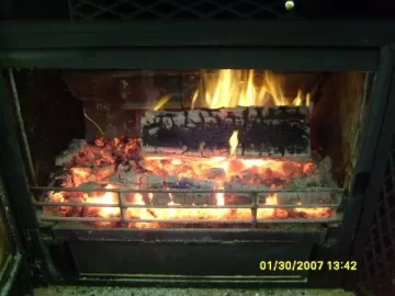

I also included shot of a typical REload of wood (about a half hour after I added splits). When I opened the door to take this photo, the cat probe thermometer read 1300*F. I added these two splits after intially starting the fire about two and a half hours earlier using about five splits. The small split in the right front has mostly burned away in the half hour before I took the photo. The split in the right rear was medium sized and will burn another hour or hour and a half.

Door after weeks of burning. It doesn't get any better than this IMO.

Arrangement of a smaller sized reload. The small sized split in the foreground has gone to coals after about a half hour.
