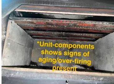

Chimney sweep said the innards are rusted out, the pipe was never installed properly and has leaks. Had it for 20 years with no issues. But he would not "certify" it as safe. They don't sell wood stoves, so he has nothing to gain. Made me me nervous when he showed me pictures of the insides. So I'm looking for recommendations for equivalent size stoves. I'm investigating Jotul & Vermont Castings. Thank you!

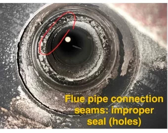

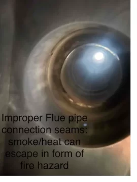

Hi Chimneychick, Sweep took extensive pictures and explained 1) flue pipe connection seams had improper seals (holes) and showed rusting and explained that smoke and heat could escape and cause fire hazard 2) components inside of firebox (tubes) showed rust and over firing. Curious why you are recommening avoiding cat stoves. thank you!

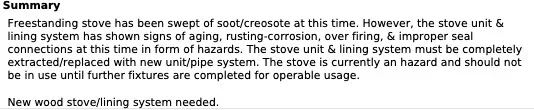

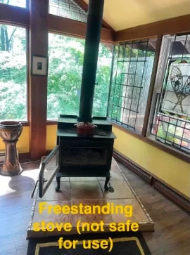

Attaching parts of the report with pictures. Sweep said not safe to use ... thoughts? Am i being overly cautious?

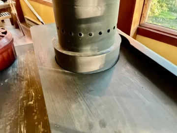

The stove interior doesn't look too bad. Is the stove connected with double-walled stove pipe? If so, that is the source of the "holes".
I dont see anything in those pics that look bad of the stove. The chimney and connections absolutely need attention but i cant really tell what's going on with them
Get that flue straighted out, and keep the stove. No need to replace it from those pics.

Absolutely right on the certify thing. There is no certification to be done. And any sweep who deems something "safe" is asking for trouble. You can only say it is installed according to code and manufacturers instructions and no defects were found.
It looks like there was a section of stove pipe on the stove when those pictures were taken. That can be deceiving. Can you pull off the stove pipe and take some good pictures inside and out of the flue outlet. Front and back on the outside.
Then, tape a light-tight cover over the flue outlet, then have a helper shine a very bright light at various points around the flue outlet base where it joins the stove top while you look inside for any light leaks.
Thanks everyone! It's double walled, and to begreen, sorry I'm not capable of pulling of the pipe. But it seems the concensus is stove is ok, but replace the piping. Will save me big bucks to not replace the stove. Thanks again for all your sage wisdom!

It may be ok. I would get a second opinion because we are just looking at a couple pics
I think it would be worth getting a second opinion, preferably from someone that actually knows this model stove.
Also, it might be the photo, but I can't see the baffle in the shots posted. Were the baffle bricks and baffle blanket properly reinstalled? The stove should not be operated without them back in.

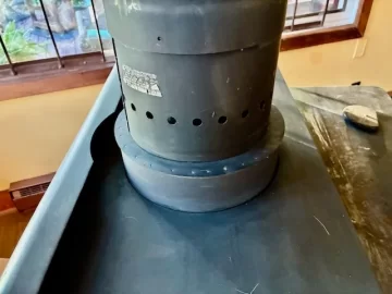

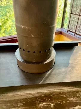

Can you post a few pictures of the flue collar on the stove? This is where the stove pipe attaches at the top of the stove.
Pixs of the tubes were taken as it was being cleaned, so he took the baffle boards and blanket out. I checked; they were reinstalled correctly ,so I'm OK with that. Attached are pix of flue on stove ... hope this is what you want begreen. Again, thanks to all!
Im not sure but that looks almost like an 8" collar with 6" pipe
Yes. The Canyon has an 8" collar but is ok to run on an 6" vertical flue according to the manual. The stovetop looks ok, but I don't recognize that 8 x 6 reducer.
I dont think it has a reducer. I think its just a trim collar
Could be, I don't recognize this brand of adapter.
Curious what to that guy shows signs of over firing?? Not being snide here I am genuinely curious because most stoves seem to look like that anyway. Mine sure does. As well as the "rusting" most of which would probably clean right off if you actually did attempt to clean it - in which case, its not even rusted! Heck mine starting forming that "rust" inside after it's first year. I'm no pro here but that stove interior looks pretty good to me for being 20 years old.
I got a buddy who bought a very old farm house a couple years ago. It has an early 90s Earth Stove (i forget the model but its one of their imports) and the baffle is very clearly cracked. Smoke seeps out of the back at start up because there's also cracking/separations in the back of the stove. Long story short, he had it inspected and the guy told him it was all A-okay! Signed off on it being safe. I couldn't believe it. The cracks are plain as day! He got it inspected again this year and that guy did not pass it. This is all to say that chimney sweeps around here in NY seem to be one extreme or the other - They either don't care enough to bend down and actually look up into a stove or they will write up 50 different things you have to change/buy from them to make everything safe.
