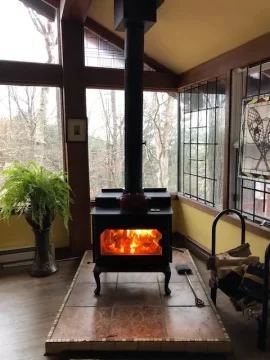

The existing flue and pipe measurements are the same from my previous stove ( which was the same dimensions as this Lopi). No elbows, double pipe. See attached pix. Full load burns for about 5-6 hours, then down to embers. Cat temp after the initial closing of the damper is about 800-900, then it goes down to about 600. Stove top thermometer. This is the same set up I had for my non cat stove which gave off tremendous heat! I don't understand why this Lopi is not giving off good temps to heat the room. I know it's a big room with windows, but the other stove gave off such good heat we could sit around in a tee shirt in winter! Thanks much

sorry forgot the pix
no picture that I can see

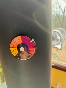

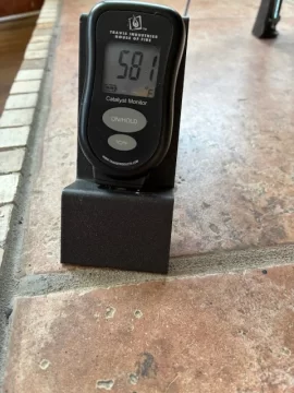

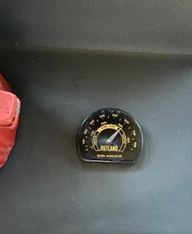

Right before the dealer installed the stove, my chimney sweep did a deep clean and replaced the cap. I'm a little confused about the temps. I'm attaching 3 images. When the Lopi thermometer show 580, the stovetop thermometer is close at around 600 ,but the condar in the pipe ( 18" above the stove) goes crazy! I'm just really confused as to what temp I should rely on to engage the cat. I've read so many posts in various forums that say 500-700 the cat can kick in. Any advice? thanks much!
