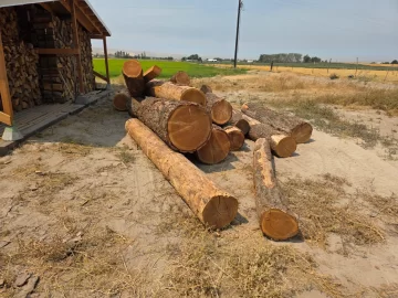

Run 3-4 cords of hardwood and softwood for past 30 years in different King stoves. New KE40 just burned in driveway to cure paint. Then buddy calls and says he's gote some big Doug Fir logs..I think good fuel is the most important facet of satisfactory wood burning. In order to get the most out of every stove, burn good, we'll seasoned wood.
