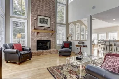

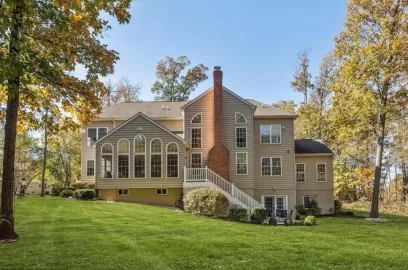

Thinking about buying a new to us house, and putting in a wood burning furnace like I did here will most likely not be an option. However, there is a gas fire place in the great room with a brick and mortar chimney. I am including pics of the great room and the back of the house with the chimney. The chimney runs all the way from the basement floor up past the 2nd story roof line. Just wondering if there is any way I can modify the hearth so I can use a free standing wood stove instead of an insert.
Yes, I know I need to check the chimney, make sure it is sound, make sure it has a ceramic liner in it, etc. and then run a stainless steel liner up the chimney.
Looking to go with a free standing wood burning stove because I have access to "free" firewood and because I think I need all the heat I can possibly get to cut down the heating cost in this house.
Anybody have any before/after pics where this was done. I'm just trying to see if this is a viable option, and if so, how it it done.
Thanks

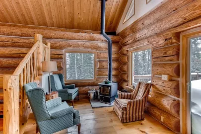

First let me say that is a beautiful home! I don't see any reason why it can't be done...at what cost and effort...the professionals here will be along to guide you in the right direction.
It can't be done, sorry.
Here's proof in case you don't believe me:
[Hearth.com] Any way to use a free standing stove in this situation? [Hearth.com] Any way to use a free standing stove in this situation?

Think I have already figured it out. I am going to weld some plate steel together with a base that will rest on the wood floor in front of the hearth. I will sit the free standing stove on top of the plate steel. Going to paint the steel black just like the stove. I'll run the plate steel back into the chimney area too. Then, I will go with black pipe all the way up to the ceiling, penetrate through the ceiling with stainless insulated pipe from the ceiling junction box, and then penetrate through the roof right there. The chimney should penetrate the roof line right at the very top of the roof. I will just need to figure out how a penetration is done right at the crest of the roof. 2 stories of single wall black pipe should help to heat the upper level of the house too.
Now, only question is going to be whether I can use the chimney for a stove in the basement.

Honestly that sounds like a terrible solution. It would look like crap and it would detract from the home's value. Why is this being proposed if the house is already heated by a wood furnace? Also, a 2 story single-wall flue is strongly discouraged. Too much heat will be lost from the stove pipe. That can cause flue gases to cool down to the point that they start to condense on the inside of pipe causing creosote buildup. The stove is the heater, not the stove pipe.

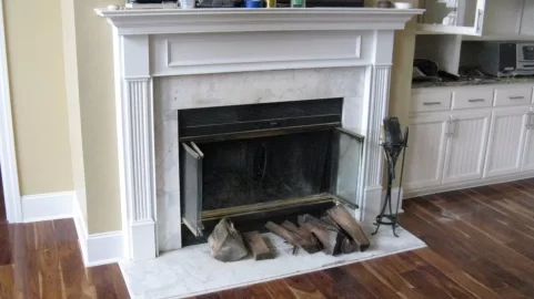

What about removing the current gas fireplace from the outside and replacing it with a high quality EPA wood fireplace that heats well?

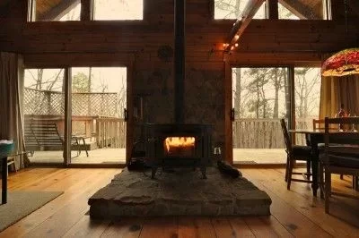

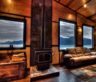

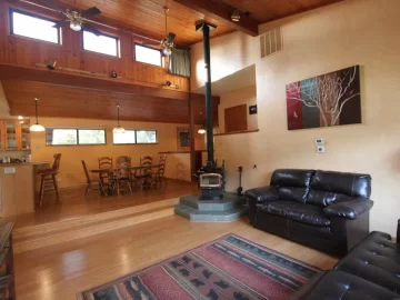

I've seen plenty of tall pipe installations. Several of those pictured appear to be with double-wall stove pipe. You'll note that all of those pictures are purpose built stove installations and not in front of an existing fireplace. If you can afford this house then why not do it right?

Hopefully the interior fireplace facade can stay in place and a new unit be installed from the outside, but without measurements it's hard to say. Contact a good wood fireplace shop that sells EPA fireplaces and have them take a look.

Put an insert in the fireplace. If you haven't found one you like, keep looking. There are some beauties available that can meet your (wife's) aesthetic needs.
If you really want a freestanding stove, find another place in the house.
You really don't want to cut into your ridge board.
I really wanted a freestander, but had two fireplaces, and was considering exactly what you are. Now that I heat the house with the insert, I can't imagine why I'd have tortured my situation by ignoring the obvious.
Don't ignore the most obvious solution.
That is a huge beautiful house to be sure.
Energy efficient? Ain't gonna happen. Too much soaring unused space and glass.
To run a pipe two, three stories up in front of a fireplace to vent a wood stove placed in front of a gas fireplace is simply visual folly.
It will destroy resale value and desireability.
As mentioned, your absolute best option is to install a good insert and vent it out the existing masonry structure. With a liner as needed.

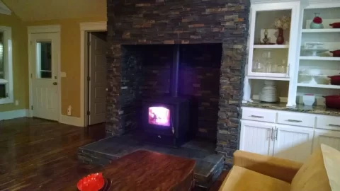

Please note that none of the pictures you found have the stove sitting in front of a fireplace. You haven't come up with some new, outside the box, solution. You just had an idea that turns out to be a bad one (we all have them), and somewhere along the way you've convinced yourself that it's a good one.

There are people who have put free-standing stoves in masonry fireplaces. I can think of @Nick Mystic, @Woody Stover, or @weatherguy off the top of my head. I know you don’t own the house, but do you have dimensions of the fireplace? It’s hard for the installation wizards of the forum to give real advice without numbers.

I agree with the consensus here. The focal point in the great room is that floor to ceiling brick fireplace. It's is a formal look, as is the rest of the house. If I understand your idea, you want to build a steel hearth in front of the brick wall and go straight up with an exposed chimney in front of the brick wall. Seams like rustic look, more suited for my timber frame cabin.
If it was my place an wanted some heat from what you have, I would go to an insert. Maybe not as much heat as a free standing, but it wouldn't change the look much. With this plan you get the same rolling fire and produce heat. Your not heating that house with one stove anyway. Plan B would be another location for the free standing stove. Then you would have the stoves heat and the convenience of the gas fireplace.

I will try to get dimensions for the gas fireplace when we go to look at it again on Thursday. Somewhat hard to measure the depth of it though with it being inside the chimney. An insert might be the only option because I cannot think of any other room I would want to put a free standing stove in.
