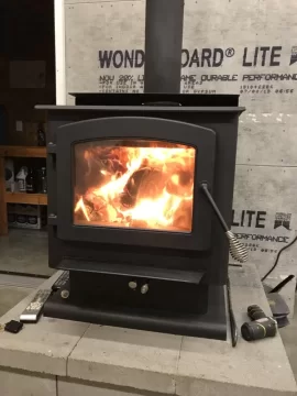

I’m no help either. 1800 sf shop with 14’ ceilings.
  • [Hearth.com] Anybody using the NC-30 in a 1400 sq ft space?
Love that install FTG. Get jealous everytime I see it.
