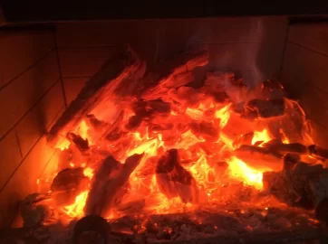

When I have a large bed of coals I open the door, turn them with a shovel and let them burn down with door open, I get an hour of radiant heat that heats up the room nicely..... [Hearth.com] Anyone else fighting a big coal bed in these temps?
