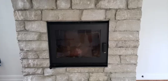

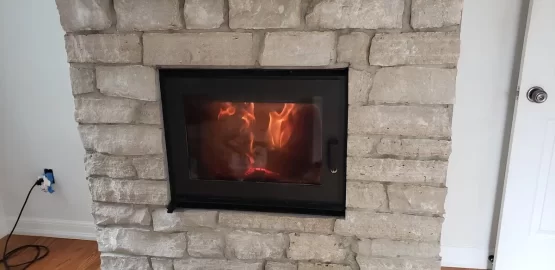

Here 2 pictures from this morning after about 15 minutes with door slightly open (1/2") .
You can see the difference, flame went out after I closed the door.
When flue temperature is high (around 500-600F) it's better, but I still have to leave intake air open to see flames.

It sounds like the cat is not even able to get hot enough to fire off. Although the chimney height is good, sometimes local terrain or chimney location can affect draft. Is the dealer working to remedy this situation for you? I'd be tempted to add 4' temporarily just as a test to see if it remedied the situation.

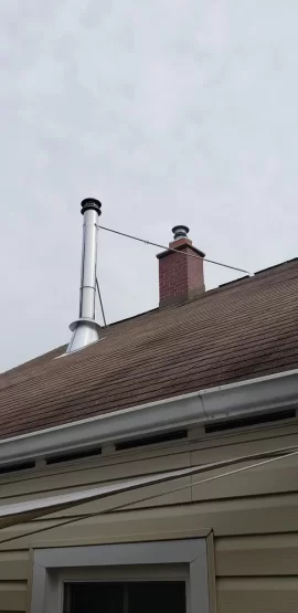

Hopefully tomorrow I'll get a reply from the dealer. I can add 4' but temporary? I have to buy another pipe and install it. And maybe I will need additional brackets because pipe is already around 7' from roof.
See picture below. Furnace chimney is about 5' from fireplace chimney.
What procedure did you use to test the moisture content of your wood? Have you tried some scrap lumber (2x4s) ?

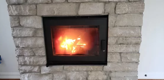

I used a moisture meter, measured different pieces in different points. Wood is at least 3 years old. Tested 2x4 as well , same.
Below picture after about 3 hours with fire on. Flue temperature is around 600F. Catalyst is on , intake air fully open.
Temporary as in - dealer comes out with a length and tests. This could be two 2' lengths and they could try 2ft first. Sometimes that's all it takes.
How and where is this being measured? Do you mean the catalyst thermometer temperature?
