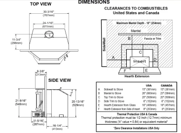

Make sure it will fit. Here are the dimensions:

Thanks much. I did look up the same diagram and it will fit. I was just inquiring to see some real world examples.
