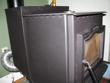

Anyone have any pics of the side heat shields installed on a P68?
I have them on my P38. Hard to tell they are on. There was a site that showed them, can't find it now.. .
There are holes/slots at the top of each plate, can't really see them unless you bend over, it creates an an air gap, so the heat flows out of the holes

So obviously, the sides of the heat shields are hot, right? But not as hot as coming directly from the stove?
The tolerances to combustibles are less, so I'm thinking they're not as warm?
You are right on all
