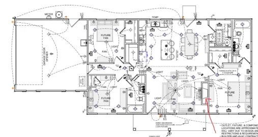

At this point it's starting to sound like a reasonable option. I have a pet peeve about things that take up space and have no function so I am kinda irritated that they sold me this fireplace. I think it's going to bother me once I move in too unless it turns out it does an OK job of providing heat with the upgrades. It is in a central location which is nice (see picture).
Still trying to find someone with a similar setup too, though it sounds like most people on this forum would probably know to steer clear of such a setup so I might be hard pressed to get some answers on actual performance.

The other thing is to have the stove in a place that is easy to get wood to without tracking a mess across the house...from where you show the FP in your drawing, I'd want it moved to the opposite wall...just inside the front door, and right down the hall from the garage...its a little more central in the house this way too (better heat distribution to the whole house)

Is the master bedroom sharing a wall with the fireplace? If so you could you could run a duct into the master bedroom, this would be a must have for my wife.
Yup, it shares a wall with the master bedroom. I wonder if any heat would radiate out of that wall into the bedroom. I'm not sure if this model supports connected ducting but I like that idea. Guess I could always sawzall a vent into that wall to better take advantage of any radiant heat :p .
