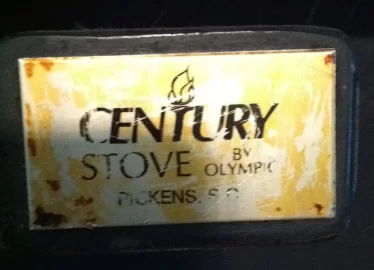

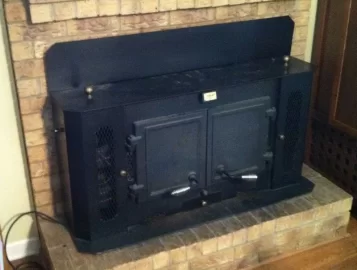

I'm totally new to trying to heat with wood, but I've been thinking about how I'd like to do it for a while. Then, last week, I was helping someone move into a new house. The new house has an insert that I think would fit my fireplace and they don't want to use it. They said to make them an offer, and I'm pretty sure they would sell it cheap.
My problem is I took a few pictures and I still can't figure out what type of stove it is, so I don't know what its worth, and I don't know if it would work in my situation.
Can any of you identify what this thing is from the pictures I took? Also, do you have any idea if I'd have any problem installing it in the fireplace of my 1500 square foot double wide trailer? I'd love it if it would work for me, but I'm stumped.

I wouldn't bother. I would get a modern (post-1990) EPA-certified stove. It will burn a lot less wood for the same amount of heat, burn cleaner on low output, and have glass on the front so you can see the fire. Tell the guy to put that turkey on craigslist for $650 like the rest of the antique stoves you see on there. ==c

It's usually specified in the manual for any particular stove weather it's approved for installation in a mobile home...you'll need to check into that.
Also, is your fireplace a brick and mortar traditional fireplace? Or is it a manufactured / pre-fab unit? If it's not a real-deal fireplace, then most of the time the pre-fab unit isn't built to handle the heat of an insert and would be a serious danger.
Being a mobile home, I guessing it's going to be a pre-fab. To go ahead, you'd have to get the manual for the fireplace and see if it was built to handle a stove in it or not. As I mentioned, unfortunately most cannot have a stove or insert added to them.
I think it's going to be a guessing game until you get a certified sweep/installer to look into your particular situation, and this is not something that should be guessed at.
As for chimney length, 15' is generally recommended, but I have less than 13' and have had no problems so far at all (only one year though), even on warmish days, but that probably depends on local conditions.
Also, keep in mind that mobile home requirements for stoves usually center on using outside air, so you would have to determine if that stove can be hooked up to outside combustion air (so called "OAK" kit).
All that said, even if cost is a big issue, still please look into a newer EPA freestanding stove approved for mobiles. You'll be much more satisfied and you should be able to find an inexpensive one. It's not just about pollution, it's about efficiency also, and the viewing window makes it so nice to look at.
Like Pen, I'd be very surprised if your fireplace installation could handle that stove. Maybe some pics?
as others have said, I doubt the unit is zero clearance fireplace, or mobile home approved
the ZC issue is the biggest issue- assuming your mobile doesn't have a site built masonry fireplace:)
