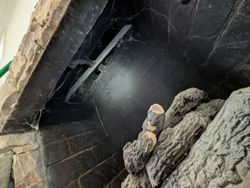

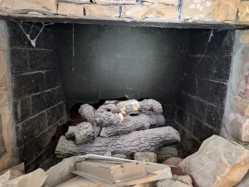

Thank you for the reminder to triple check. I am pretty sure it is, do the attached images help to confirm whether it is an actual masonry fireplace? Can I provide other images if these aren't enough, just to be sure?
I think so but can't exactly see what is solid brick and what might be behind it.

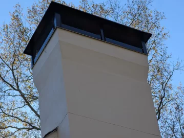

It looks like a masonry firplace. Is this an exterior wall fireplace or interior? If exterior, is the brickwork exposed?
Exterior wall. Unfortunately the house is "stucco", so no brickwork to be seen. Would it help if I took a pic of the entire chimney?
It will be evident when the chimney is thoroughly cleaned before installing the insulated liner.
