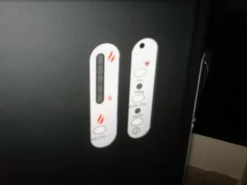

This is what I see.
  • [Hearth.com] Anyone know where the Thermostat switch is on a Enviro MINI? SOLVED
Like you, I have the older version of the Enviro Mini where the HI/Low-on/off mode is controlled by a jumper. I got tired of removing the side panel each time I want to change the mode, so I wired in an SPST toggle switch to jumper pins.
Only annoyance is that the computer only "reads" the mode setting when the power cord is first plugged in. This means that each time I flip the switch I need to shut the stove down, then remove the power cord for a few seconds.
