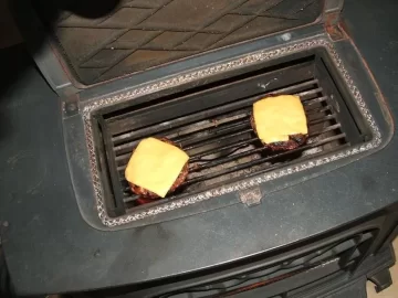

Don't forget the cooking grill!
  • [Hearth.com] Anyone like top loading stoves?
