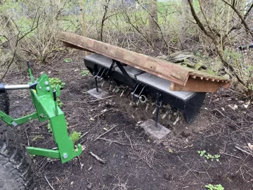

I use them to make roofs for equipment I'm forced to leave outside. Light frame of 5/4x3 cedar rafters, 1x2 pine purlins, and cedar shakes. A 6' x 3' roof is light enough that I lift it off with on hand. A bungee can be added between rafters and equipment, if left in a high-wind area, but most of mine are just gravity-held. Frame has cleats added to hook onto or set upon equipment with which they're used.
Last one I built was probably 5+ years ago, shake price wasn't too bad then, but haven't checked since. Can try to find (or take) a photo later, if anyone is interested.

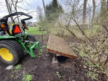

Took me awhile to remember, but here’s some photos of one I’ve had on my 60’ish inch aerator the last several years. Photos taken this morning.
