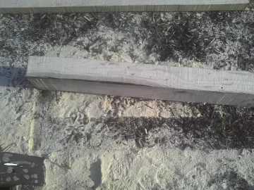

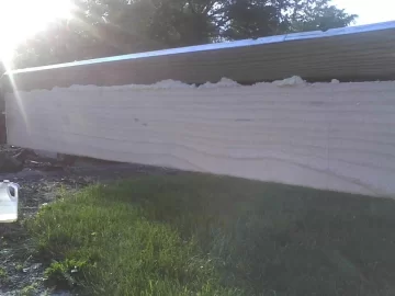

Mini Mill with a 192t cutting out beams. 4 inch think ash. Hated the mini mill as a log first cut but as a re-saw too its pretty sweet, and the narrow kerf of the 192t its a nice little set-up.

Side that the mini cut.

10 foot ash beam. 4x6
Wow.... That's damn close to the cut I get with Lenox 3/4 varitooth .035 gauge bimetal bands.
Gide Broad is 1/4 inch off the cut. Makes it pretty easy set-up and yes it looks good. (for a chain saw)
