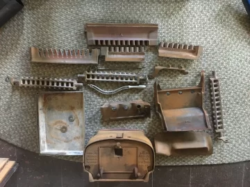

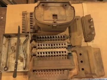

View attachment 281361 View attachment 281362
Yeah they really are just coal stoves. Yeah you can burn some wood but not well at all

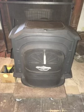

my “new” resolute coal stove! It was used to burn coal throughout its life, so it is really clean inside (no creosote) and no metal damage.
[Hearth.com] Anyone still burn coal? [Hearth.com] Anyone still burn coal?
View attachment 281446 View attachment 281447
Well of course there won't be any creosote in it if it was only used for coal lol. By the look of those internal parts it was very well maintained. And I don't think it was used very hard. What chimney will this be hooked to?
the owner used it significantly over the 40 years of ownership. generally speaking, i could tell he is a "professional amateur", so not surprising the stove is in exceptional condition. he said the coal kit wasn't immediately available, so the stove burned wood the first year. then only coal since until a few years ago.
and yes, no creosote with coal. seen some really bad old stoves caked in the stuff. making me rethink coal, at least for these older stoves (and yes, i know about dry wood).
PO liked the coal also because it would still be going in the morning, unlike many wood stoves that need to start all over every AM.
